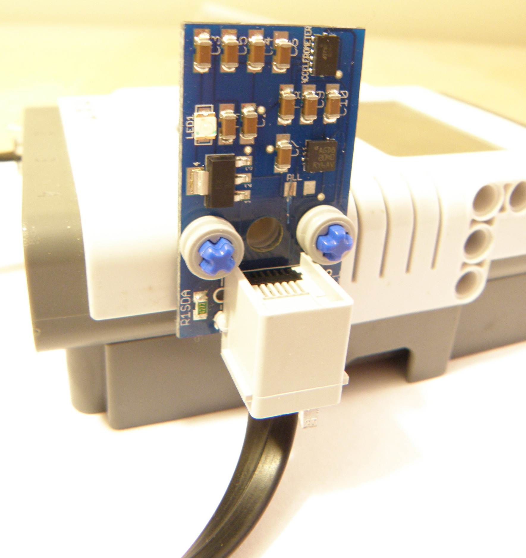

Using RobotC, you can download this program, drag it all over the earth, and then snap! open the file in Google Earth and see where you went.  In five easy steps.
  1. Upload our program.  (Can you do better?  Send us something!)
  2. Attach the dGPS, get a signal.
  3. Start the program and proceed to wander.
  4. Stop roaming.  Download the file “Path.txt” to your desktop.
  5. Rename the file to “Path.kml”.  Double click the file.  Voila.
