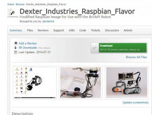

- If you are using Raspbian for Robots, upgrade the SD card image to the latest version of the Dexter Industries “Raspbian for Robots” image. You can download it here and follow step by step instructions here.

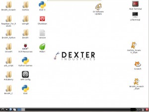

Updating Raspbian for Robots
Your Raspberry Pi relies on the SD card image to know what to do. The Raspberry Pi Foundation has updated the image (they call Raspbian) for the new Raspberry Pi 2. Dexter Industires has our own version of Raspbian, called “Raspbian for Robots”.

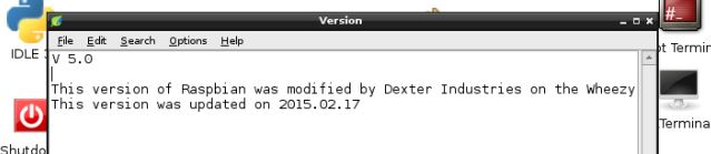

Our new version of Raspbian for Robots is Version 5.0.

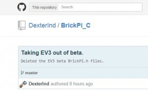

Updating BrickPi C Files
If you’re a fan of C and the BrickPi, We took some time rewrite the BrickPi C files. This was long overdue. The previous version of the BrickPi_C relied on wiringPi, which we had to customize to run on 500,000 baud. No more! We updated the files to run on termios. You can check out the details of the most recent changes in BrickPi.h here.
If you’re intimidated by C on the Raspberry Pi or gcc, give it a look: we added some extra documentation that should make compiling and running the programs a lot more straightforward.
