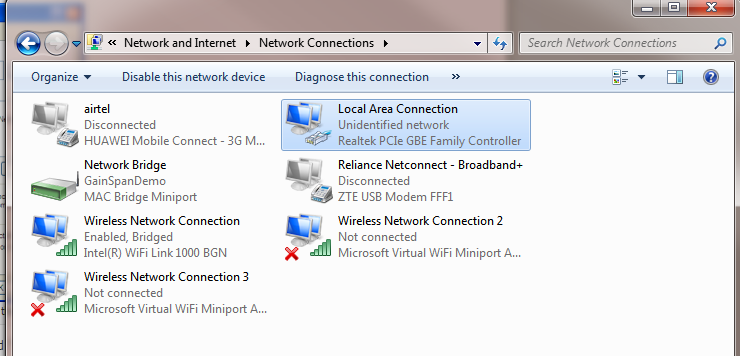

- Find your “Network Sharing Center”.

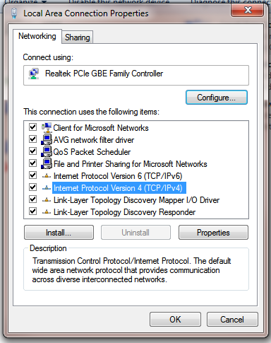

- Find the “Change Adapter Settings” –> Local Area Connection, click on “Properties”.

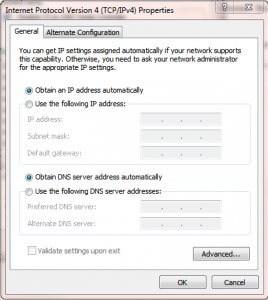

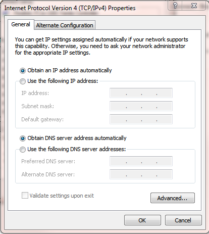

- Click on Internet Protocol Version 4 (TCP/IPv4). Make sure that you’ve selected “Obtain an IP address automatically”

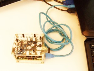

- Plug one end of your ethernet cable into your Raspberry Pi, and the other into your computer ethernet card.
- Power the Raspberry Pi up. Be sure to use a 2A USB Power supply.
- You should see all of the lights flashing on the Raspberry Pi! The ACT light on the Pi should blink, and the power light should be on. If you are successfully connected to a PC, both of the lights on the ethernet port should be on or blinking.

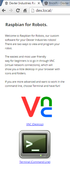

- You should be able to connect to the IP via Putty or VNC. In the latest version of Raspbian for Robots, you should be able to to connect to both through your browser. Simply type “http://dex.local” into the browser on your PC. If you are connected, you should see the dex.local page. Click on the VNC icon for the desktop, or the terminal icon to open up terminal.
