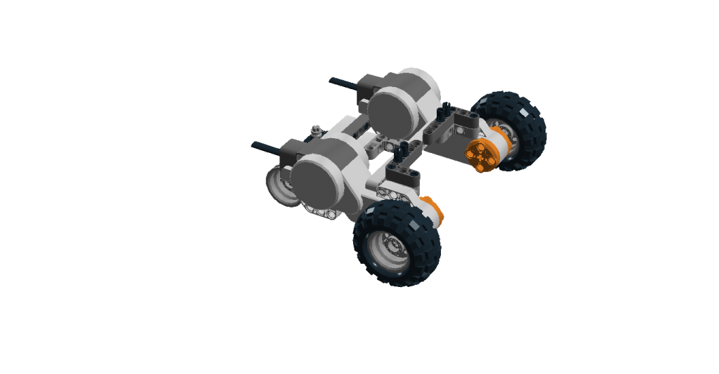

LDD Building Model:
We also put together a LEGO Digital Designer Model which makes building simplebot . . . simple.
simplebot

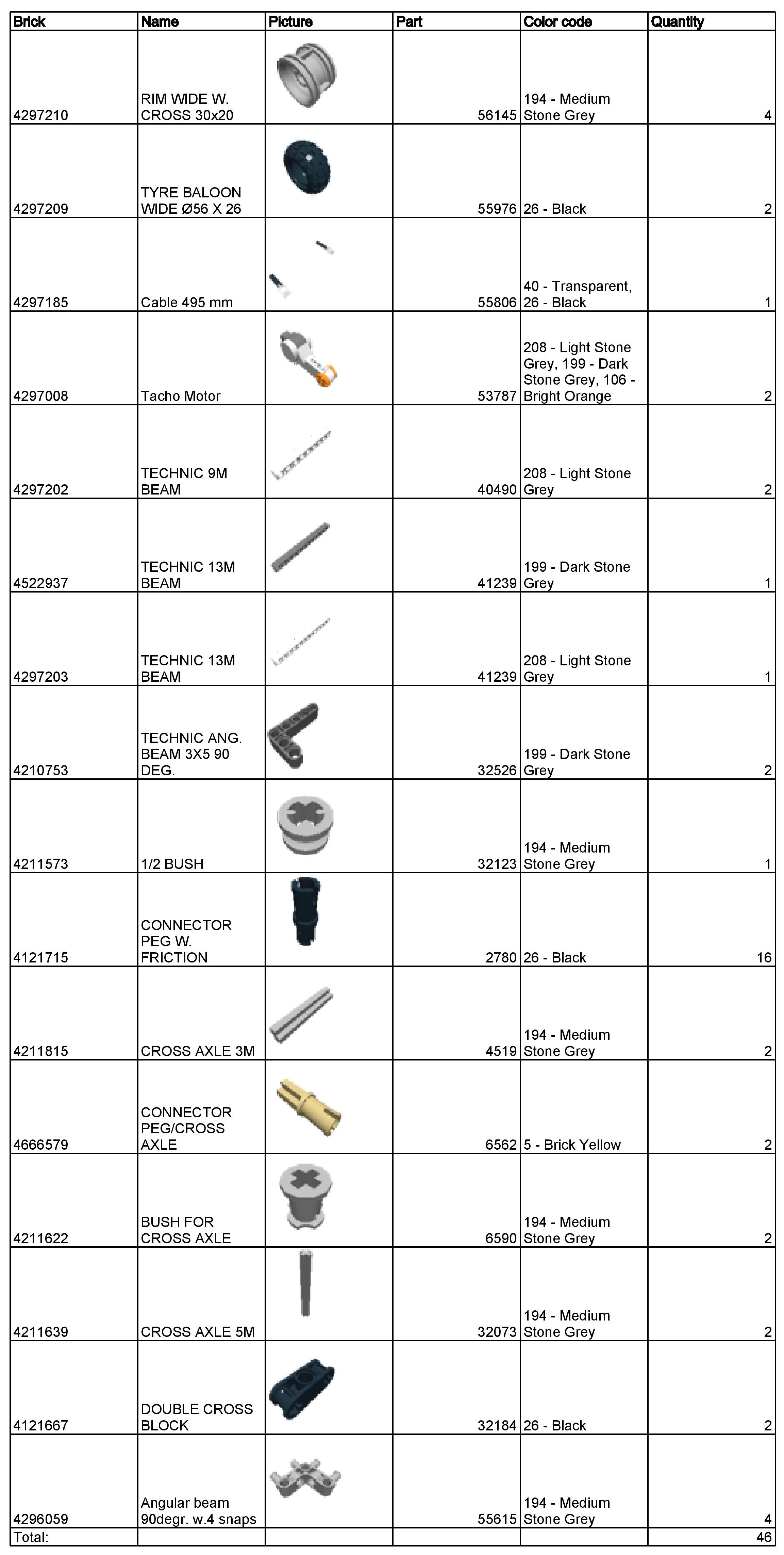

Bill of Materials:
Here is a detailed Bill of Materials. You can also download it in Excel format from our Github Repository
simplebot_bom-page-001

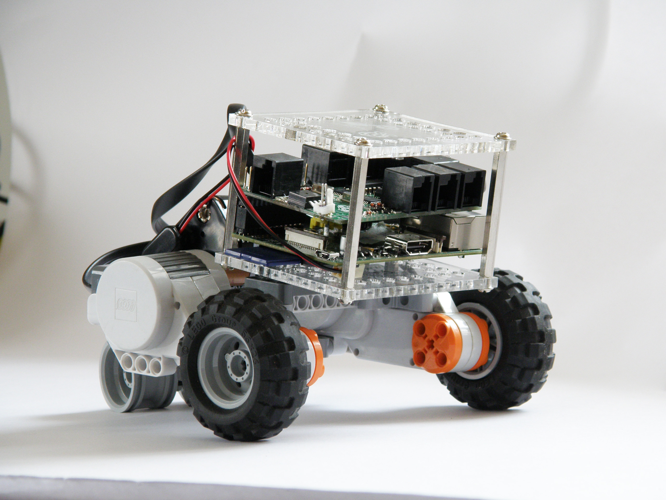

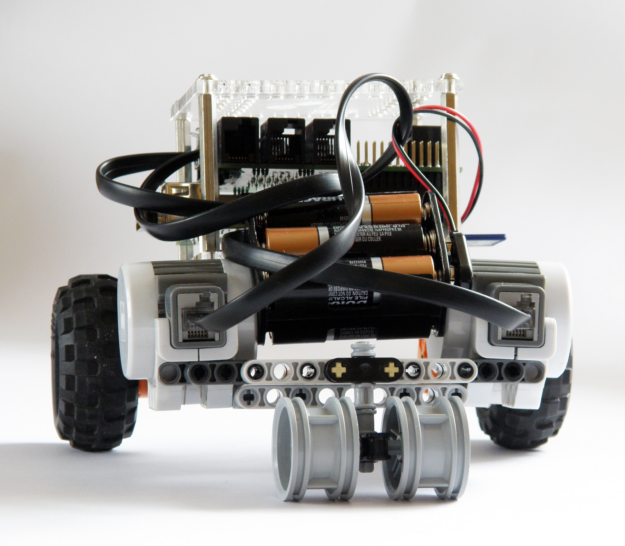

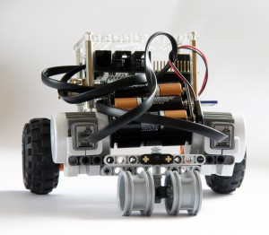

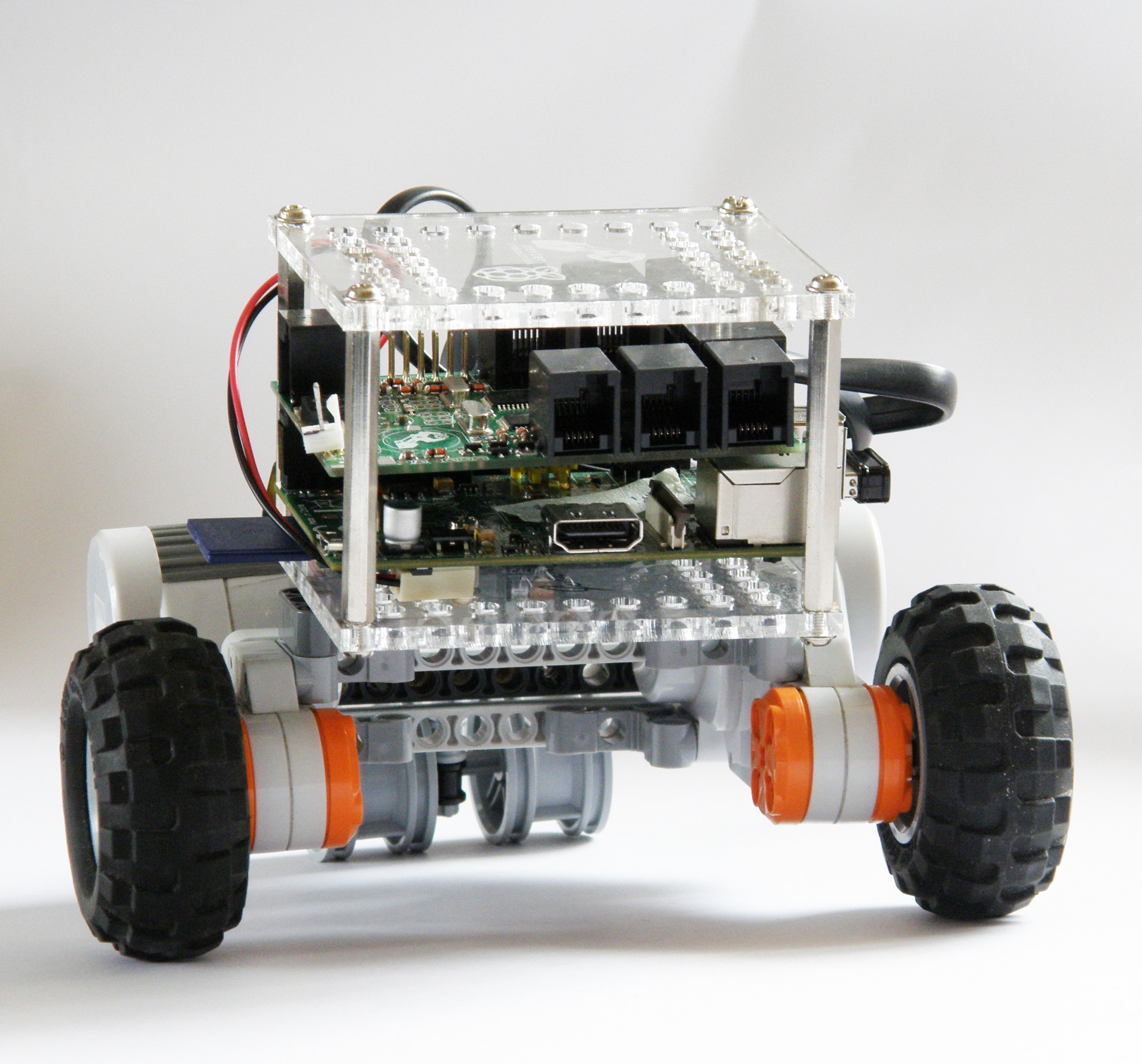

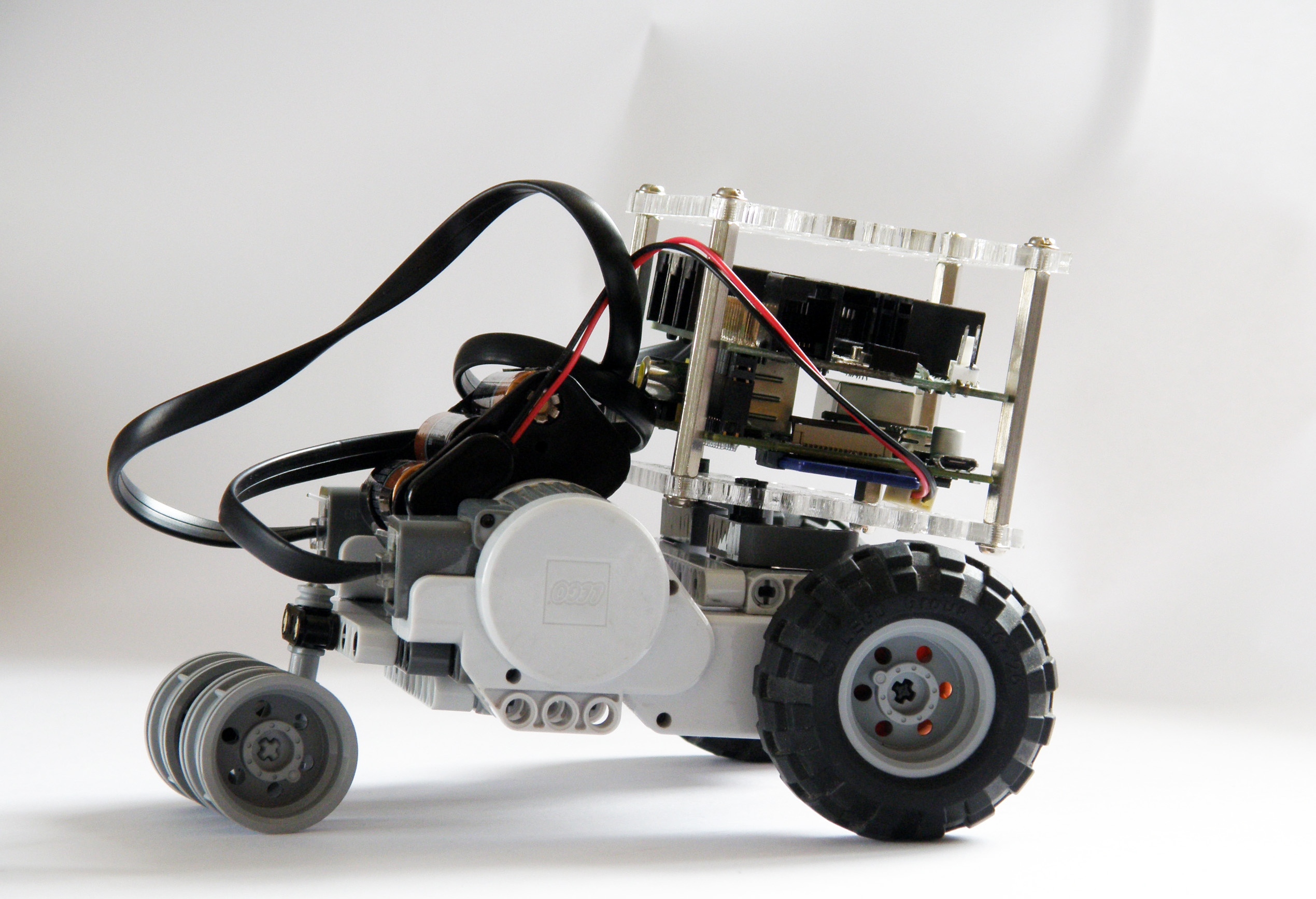

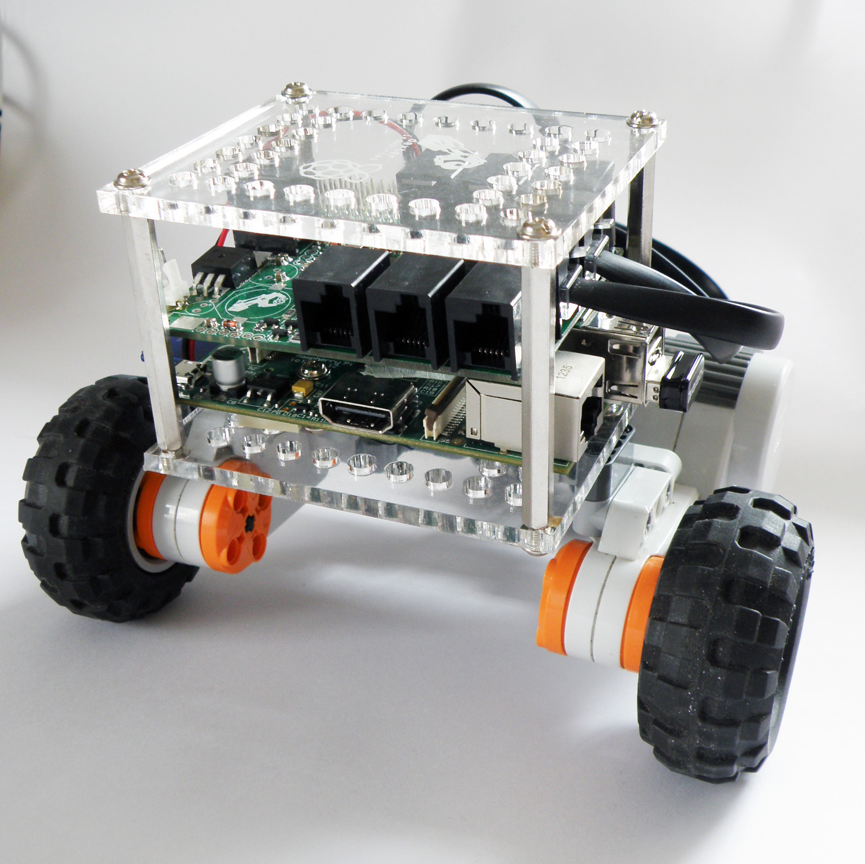

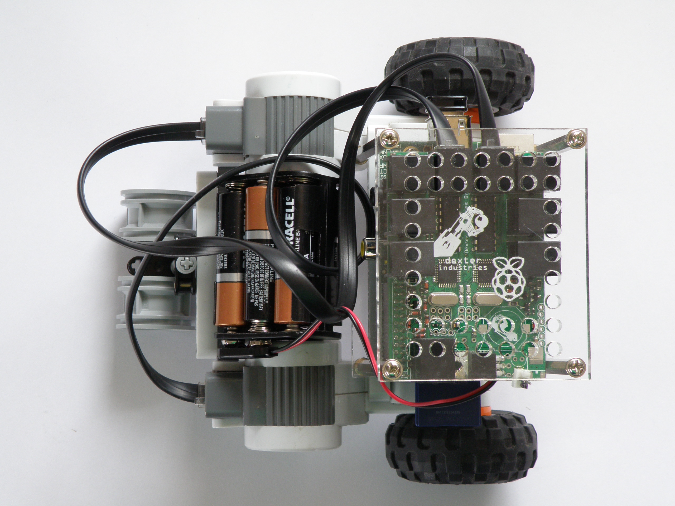

Pictures
Here are a few more pictures of the Simple Bot.
