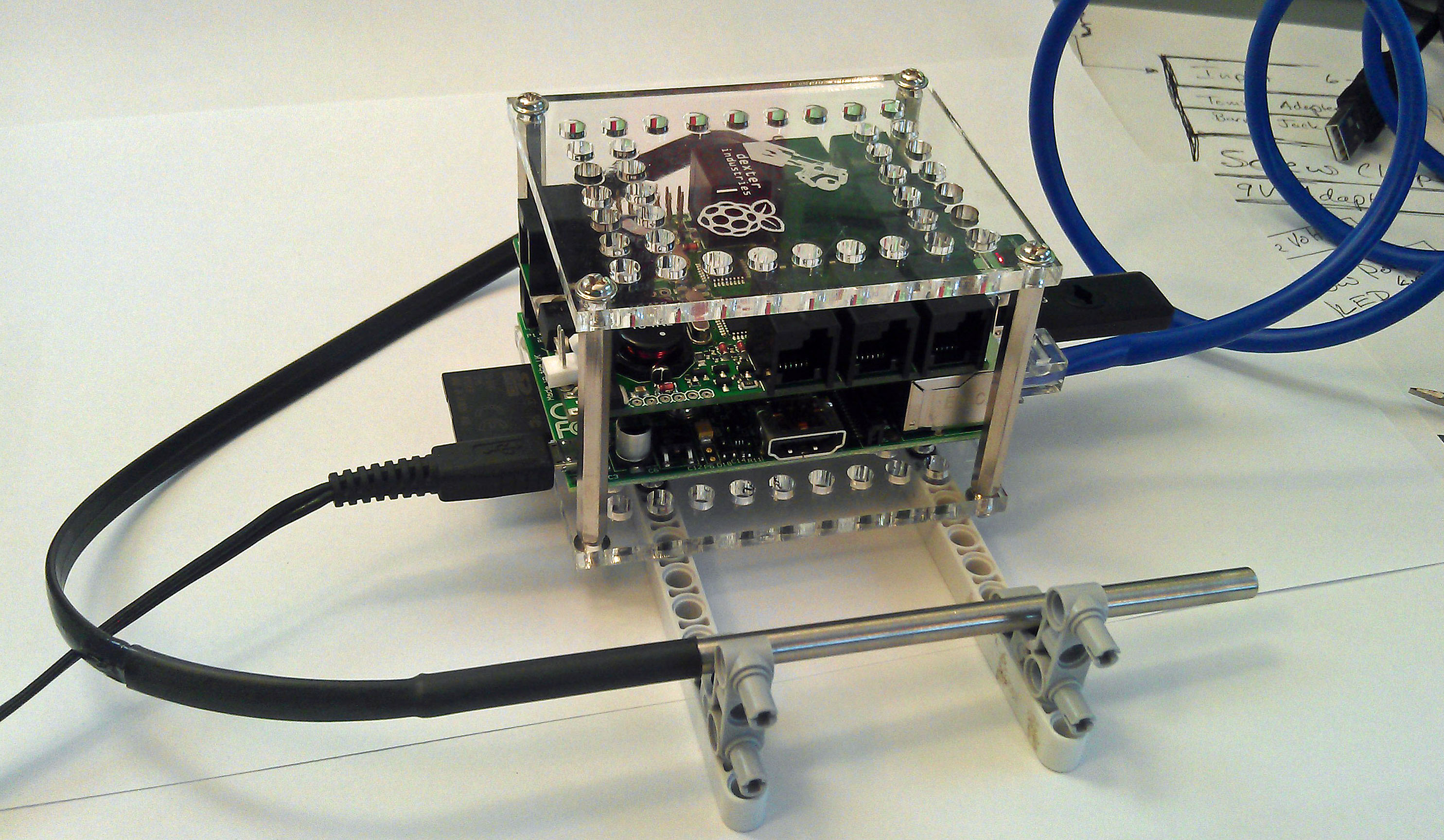

Building the weather station is very simple.  You’ll need:
The BrickPi draws very little power reading the temperature sensor, so it can be powered from the Raspberry Pi.

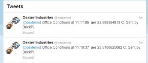

If we check our Twitter feed, we should see something like this:
Succesful_Tweet_from_Command_line_in_Twitter
Success!  Pat yourself on the back and send another Tweet!
