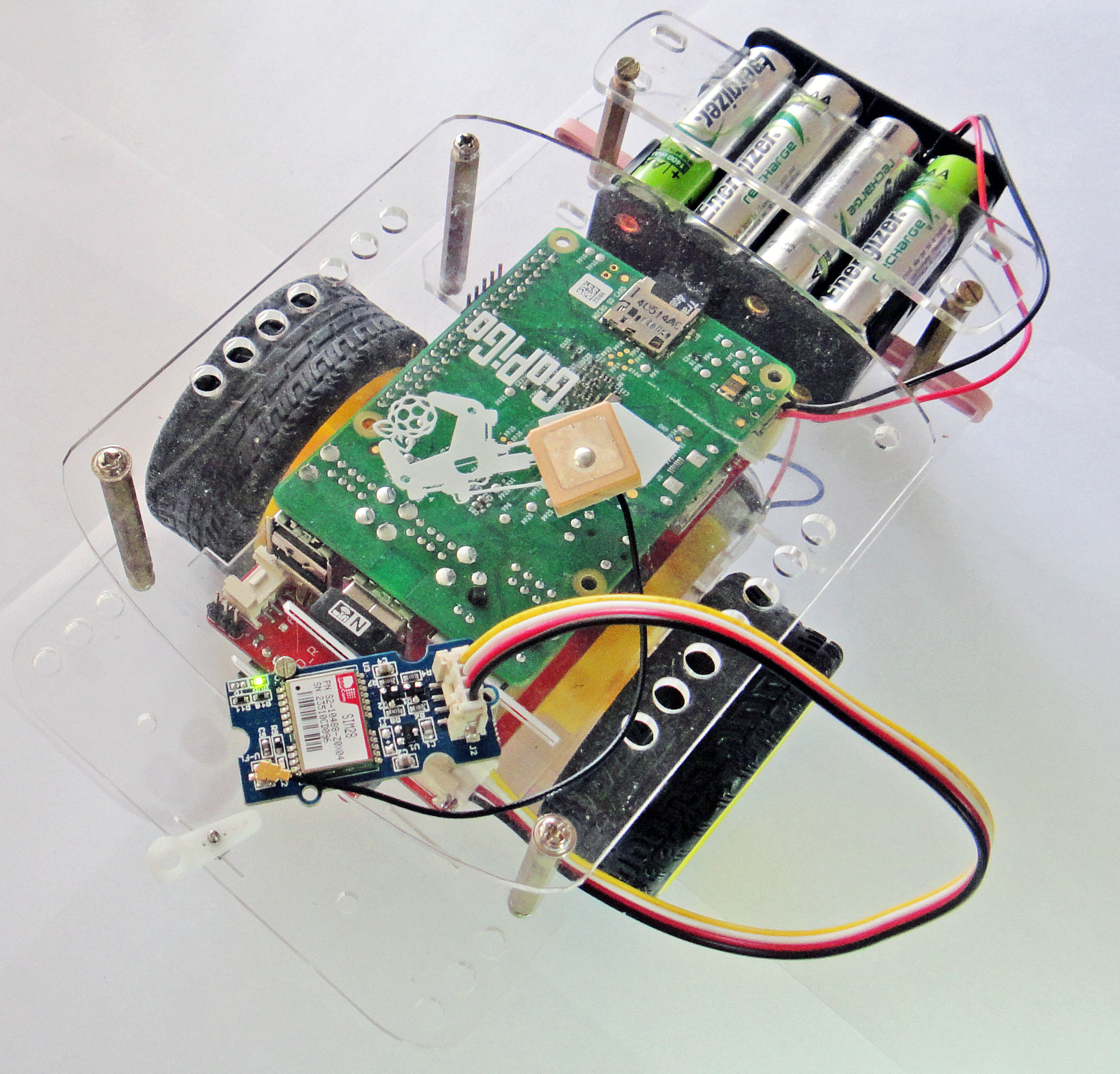

- Grove GPS sensor
Connecting the GPS
- Take a Grove connector and take out the yellow and white cables and cross them over, so that the connector is now “BRYW” from the original “BRWH” configuration.
- Now attach one end of the cable to the GPS and the other end to the Serial port on the top side of the GoPiGo
- Now fix the entire module on the top plate using screws and mounting holes

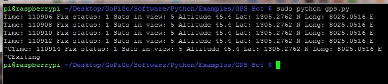

Running the example:
- Go to the GPS bot example folder:
cd Desktop/GoPiGo/Software/Python/Examples/GPS Bot/
- Start the basic_robot_control.py example
sudo python gps.py
You can easily adapt this example to any project that you have in mind with the GoPiGo and the GPS sensor.
