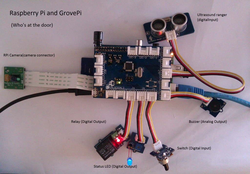

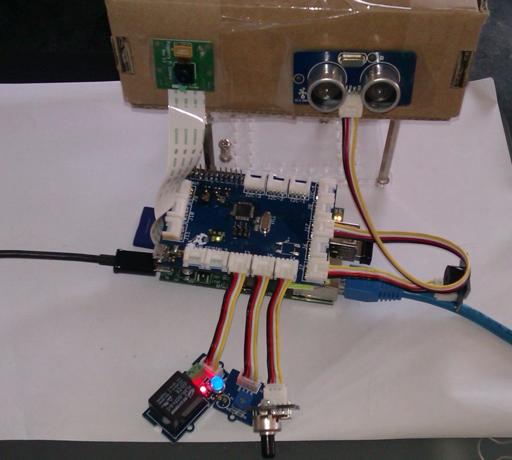

We wanted to make a small project to track the folks that came into our lab. Using some sensors we had for the Grove system, we connected them to the Raspberry Pi, along with a Raspberry Pi Camera, to add some security to our lab.
We use an Ultrasound Sensor to detect if anyone has entered the room. We use a Raspberry Pi Camera to take a photo of the intruder, and the Raspberry Pi sends an e-mail to us. We added a few actuators like a status LED, a relay used to control any electronic circuit (because we can), a power switch to turn the entire thing on and off, and a buzzer which makes a loud sound whenever someone comes in.
Setup
So here’s how all the sensors connect:
- Raspberry Pi Camera – camera connector near the Ethernet Jack on the Raspberry Pi
- Ultrasound Range Sensor– Port D7
- Buzzer– Port D5
- Switch– Port D4
- Status LED– Port D3
- Relay –Port D2

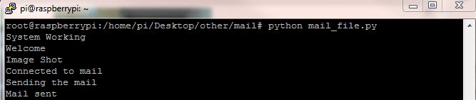

And here’s the terminal output on the Raspberry Pi tracking our lab security:
