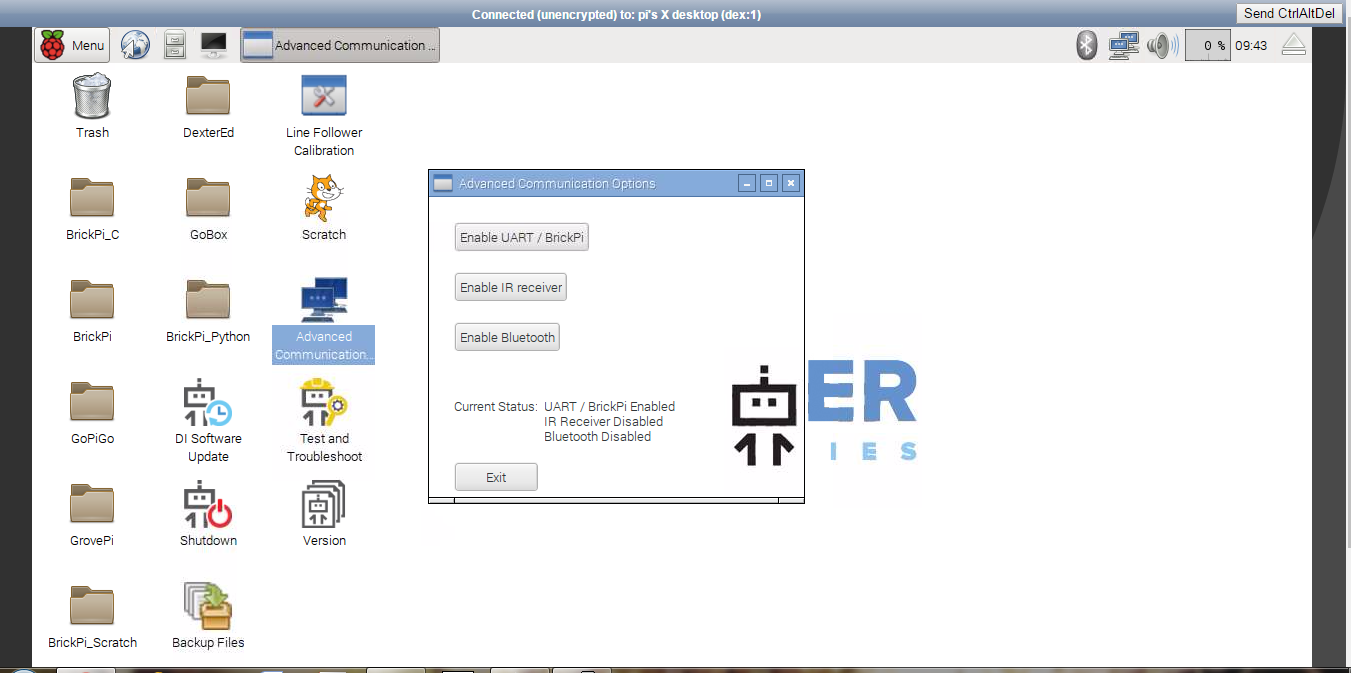

If you are not able to get a response from the BrickPi+ motors and sensors, we recommend updating the serial communications ports on the software.  This can be done on the Desktop of the Raspberry Pi.  Logon with VNC or using an HDMI monitor.
1).  On newer versions of Raspbian for Robots, click on “Advanced Communications”

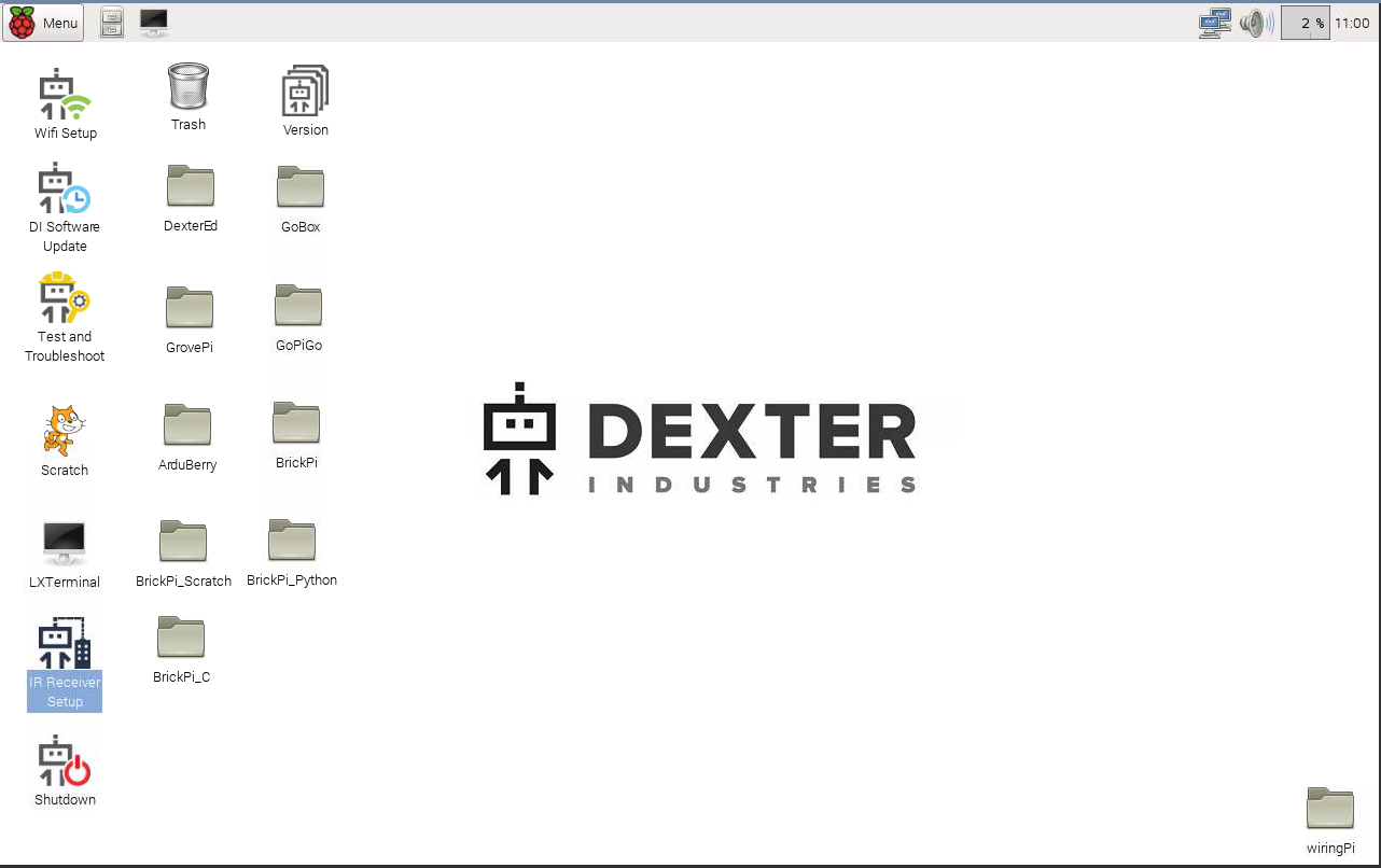

On older versions of Raspbian for Robots, click on the icon in the lower left “IR Receiver Setup”.
IR_Receiver_Setup

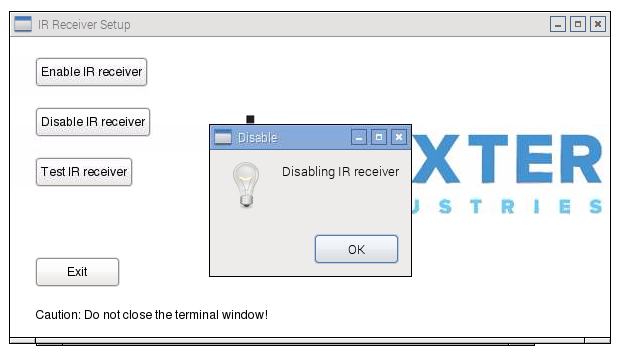

2).  If you want to use the BrickPi, select “Disable IR Receiver”.
IR_Receiver_Setup_2
3).  A dialog will pop up telling you the IR receiver has been disabled.

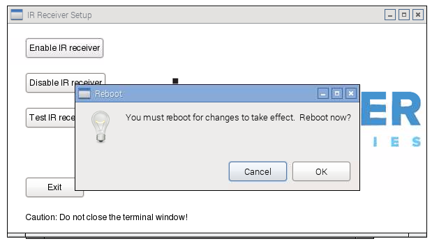

4).  Click “Exit.”  The program will allow you to reboot.  For the changes to take effect you must reboot your Raspberry Pi.
IR_Receiver_Setup_4
