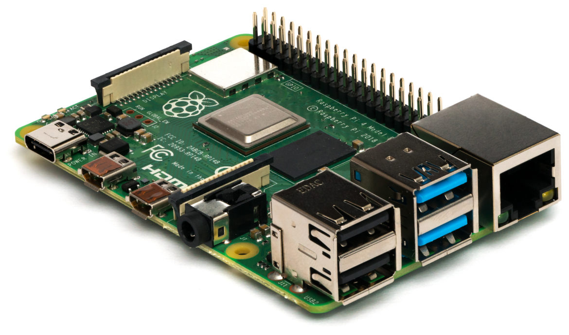

Raspberry Pi 4 Model B
We’re releasing an update to Raspbian for Robots and this one is based on Buster !
This update makes Raspbian for Robots Raspberry Pi 4-compatible out of the box/download. We’ve taken the opportunity to make some changes to how we pre-install all the tools that make Raspbian for Robots an ideal OS for running the Dexter Industries robots.

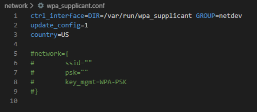

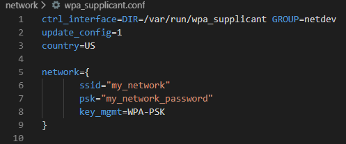

You will need to edit wpa_supplicant.conf to enter your wifi network name (ssid) and your network password (psk).  There’s already a method in Raspbian to load up this information but it’s a transient one; on boot up, the file will be transferred and will no longer reside in the /boot folder. Our approach gives you permanent access to the file.
Uncomment the appropriate lines (5 to 9 in this screenshot) by removing the # sign at the beginning of each line, then fill in your network information.

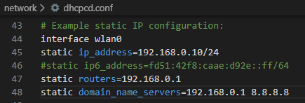

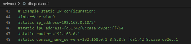

You prefer to deal with a fixed ip address? Then you can edit the dhcpcd.conf file and modify a few lines near the bottom of the file. Uncomment the appropriate lines, set the addresses that make sense in your network, and save the file.
Note: line coloring may differ.

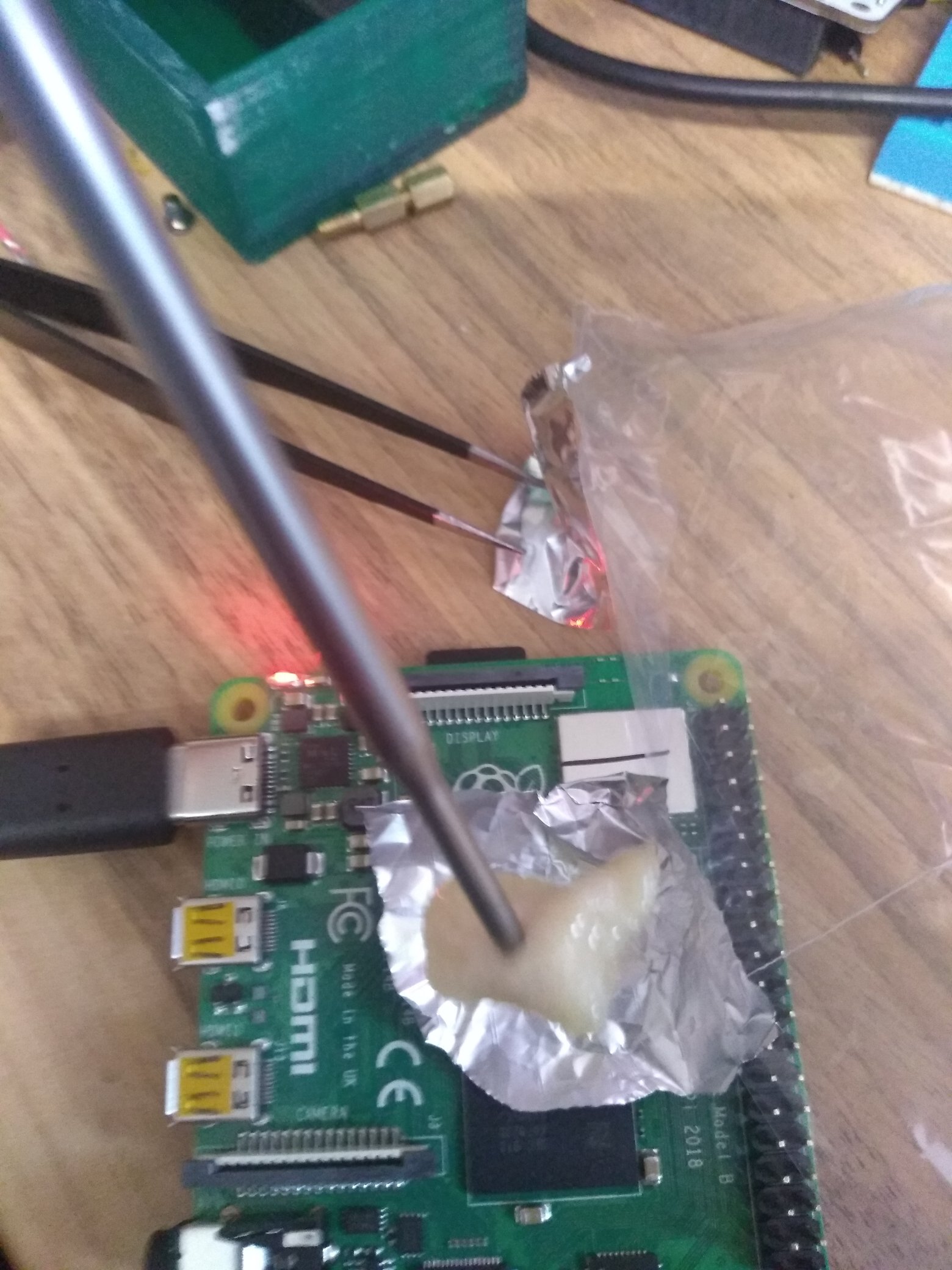

At first, there were issues with the Pi 4, mostly related to overheating. This had the side effect of going through batteries pretty quickly, and we were not too keen on handing kids a robot where they could literally feel the heat. Some engineers, aka @ryantech, even attempted to cook chicken on their Pi4!
As of the end of September, this was addressed with an update to Buster. While the Pi4 is still the hungriest of all the Pis out there, the latest firmware brings its heat down quite a bit and it does provide a lot more computing power if you’re interested in any type of machine learning, like computer vision.
